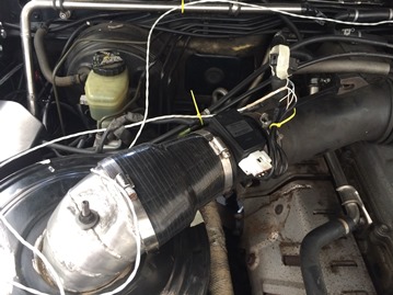

The MAF I installed was off the latter model 1997 80 series land cruiser when they changed the computer system from OBD1 to OBDII. I went with this meter as I know it is already sized for this engine, it has a THA output (IAT sensor) so no having to sort something else out there. This MAF was a little harder to source but I think it was the right descion. There is the Landtank MAF housing out there and I was keen to go for it but the cost put me off if this wasn't going to work.

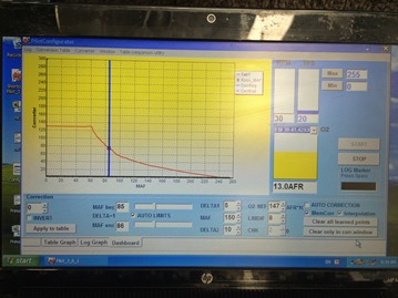

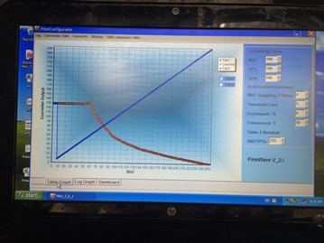

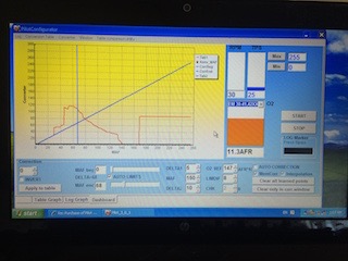

It took a bit to get started as I had no idea what I was doing, I would crank and the O2 would give me a brief AFR so I would move the graph a bit unit I got it running very lumpy and really rich. I knew the VAF had an output oppersite to the new MAF, so I clicked invert box and then turned on the auto correction. This lets the engine run a lot better. And from here I started to build my mapping table. You can see from the photo's how it developed. this really average looking table was all done with the truck stationary through different RPM's. This table was rubbish on the road though, with flat spots, lean rich, engine stuttering etc. The final table I have made runs the truck perfect now.

Photo's of the first stage install the initial tune that was very rough.
Graph also of the finish tune for now, will continue once the turbo is installed.
Jim вне форума   Ответить с цитированием

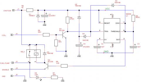

You will notice in the diagrams that the VAF has a built in fuel pump switch so that when the flapper first moves open on the initial crank of the engine the fuel pump is told to start running.
The MAF does not have this feature, so I asked for Pin help here. Attached is what he said most of the guys run that he knows of.
It's just running off the coil.
I've attached both the original and my drawing. I have modded slightly as I just want the relay to connect and disconnect the original 2 wires for my pump. so no real load being carried by the relay.

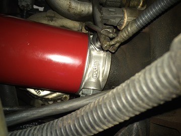

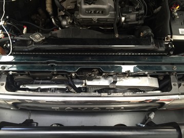

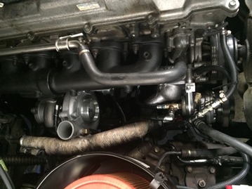

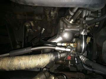

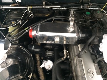

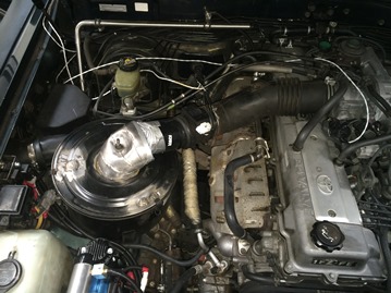

This is as far as I have got so far. Turbo is currently being installed, in spare time. And I need to build the circuit board above. Have got all the components ordered.
I always mount the oil feed off a flexi line as if that small line breaks its all over pretty quickly. I learnt this from someone else when I was building my jet boat.
As you can see my filter box is reasonably modified, 4 inch stainless steel 45degree bend chopped and welded to a tight 90degree then heated and squashed to fit the lid nut back on and to fit under the bonnet.
Everything will be excessively wrapped to titanium lava rock weave heat wrap. That stuff is amazing. I don't even bother about the old white wrap anymore, this new stuff can handle twice the heat continuous.

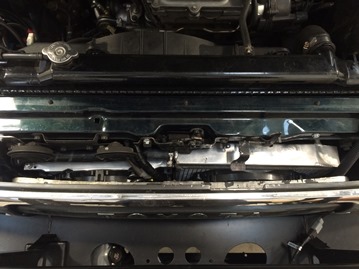

Water to air intercooler setup is already installed, water to airs are more effecent than air to airs in my option and can fit them in tighter spaces. The radiator for this system is mounted with 10" fan on seperate temp controller. I found these temp controllers that have a good range of adjustability, not 100% if they will work yet but for $3 each can't go wrong.
Also running an oil cooler, thermostat controlled sandwich plate under the oil filter.
And running seperate cooler for the automatic trans, wanted to get the trans oil out of the main radiator to help prevent heat build up in the cooling system.
Both the Oil cooler and trans cooler share another 10" fan, this will also be on its own temp controller
